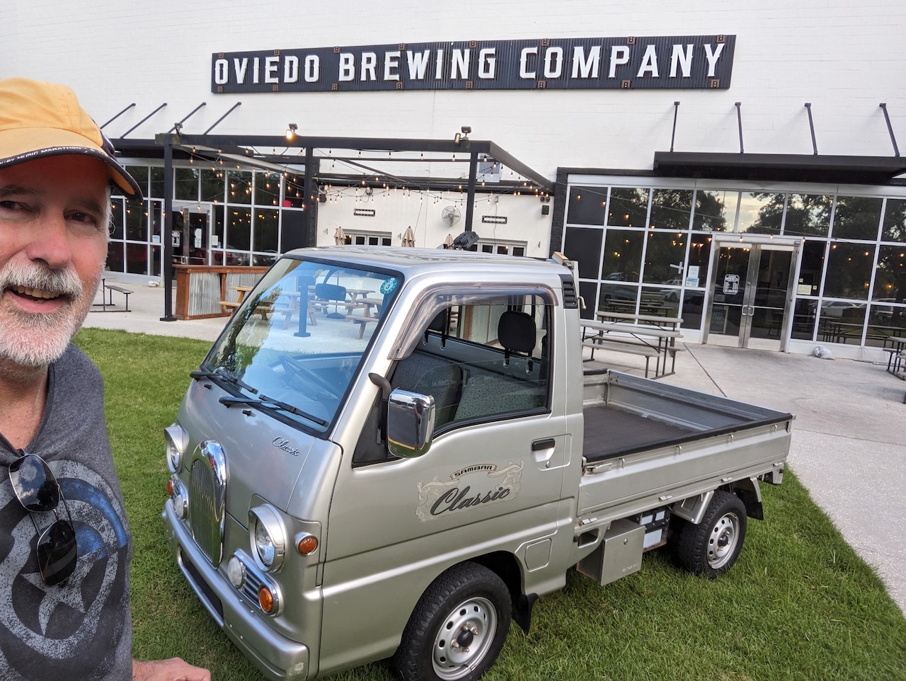

My Options and How I Imported My 1996 Subaru Sambar

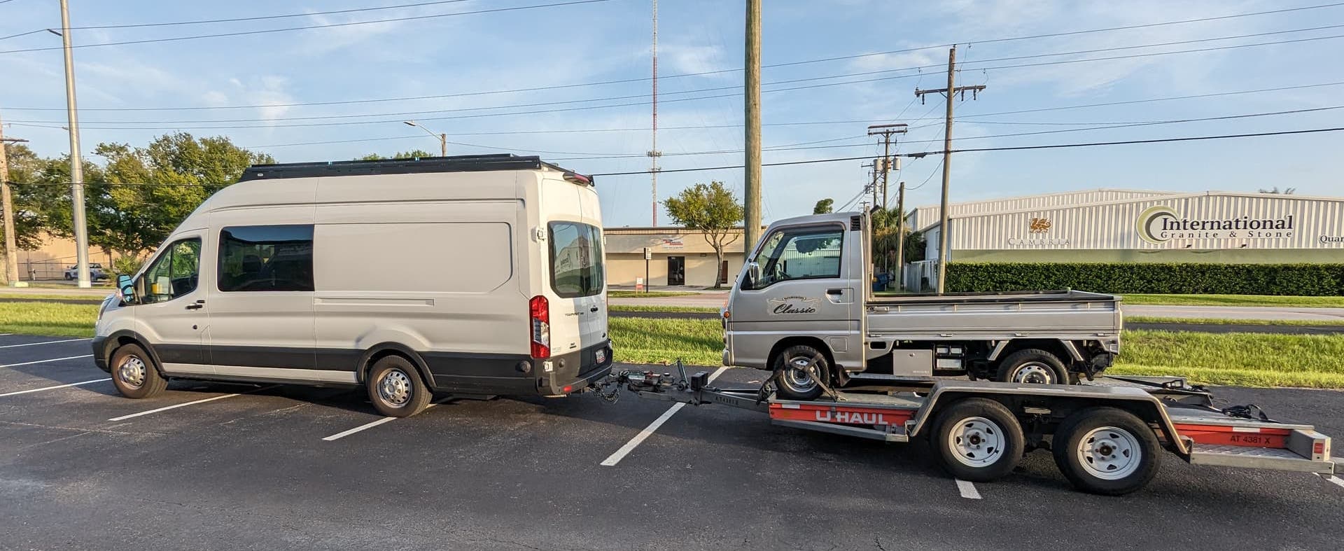

I decided to purchase from a U.S.-based Japanese car importer, Japan Car FL. This decision allowed me to drive and inspect the vehicle before finalizing the purchase. It was a matter of balancing risk, trust, and timing. After several days of texting and sharing YouTube videos, I conducted a video inspection of the vehicle on the morning of the purchase. Satisfied with the inspection, I rented a trailer and traveled to the seller’s facility.
At the facility, I saw a dozen impressive Japanese cars and was pleased with my choice. The transaction, which included a PayPal deposit and a wire transfer, was completed within a few hours on the same day. My financial institution even called to conduct a fraud detection check and was satisfied with the process. Everything went smoothly, and I was able to negotiate, inspect, purchase, and receive the vehicle all in one day.
