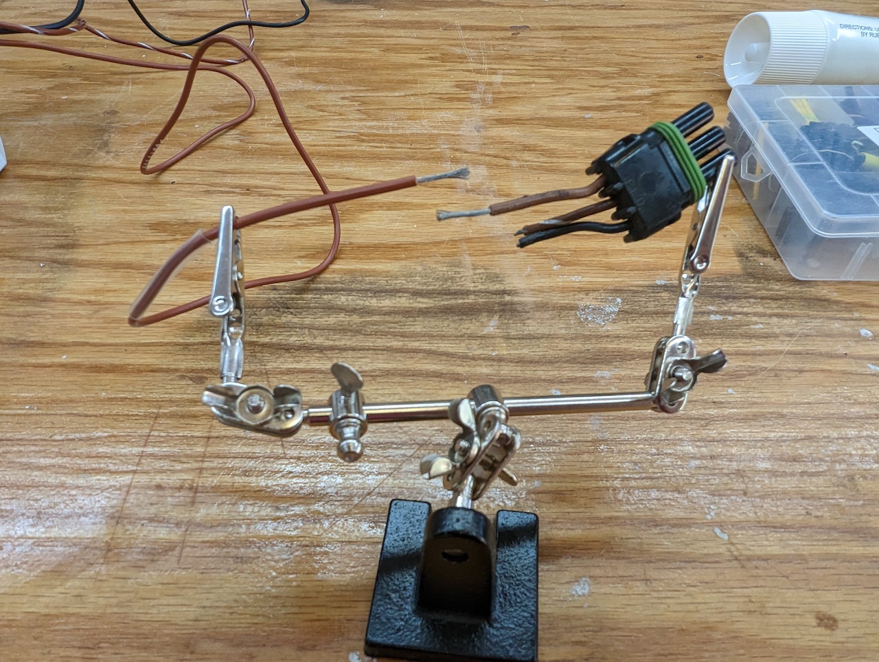

In this example, I’ll walk through how I would solder wires for use in a wet environment. To get started I have stripped about half an inch of wire from each of the brown wires. The Klien wire strippers are the best and mechanically one of the most interesting tools that I own.
The Helping Hands are used to hold wires in place. I’ve used larger versions of this type of helper device, but I have found I only need two extra hands. You can spend a lot more but this is all you will need.
Helping Hands are a big help for more complicated tasks

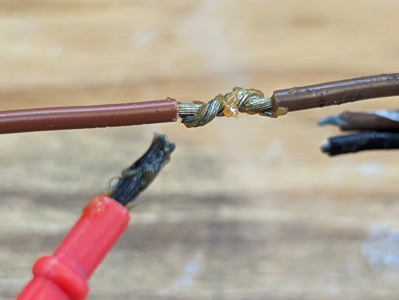

Next you twist the wires together, without making any lumps, get has much contact between the two wires as possible. Make sure no wire ends are sticking out, they can puncture the shrink wrap installed later Now apply Rosin Soldering Flux to make the next step easier.

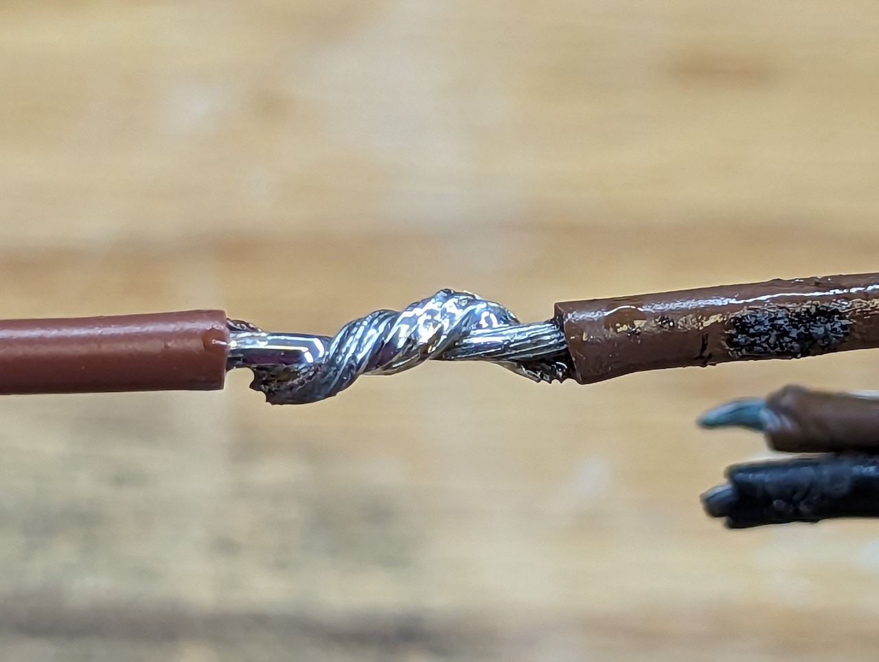

I solder the wire using lead solder and a butane soldering iron. You can see in the picture that the wire casing is a bit charred but that was not by me, this wire was used in a rather harsh environment. I think it was riding on an exhaust pipe for a while. I’ll cover most of the char with shrink wrap.

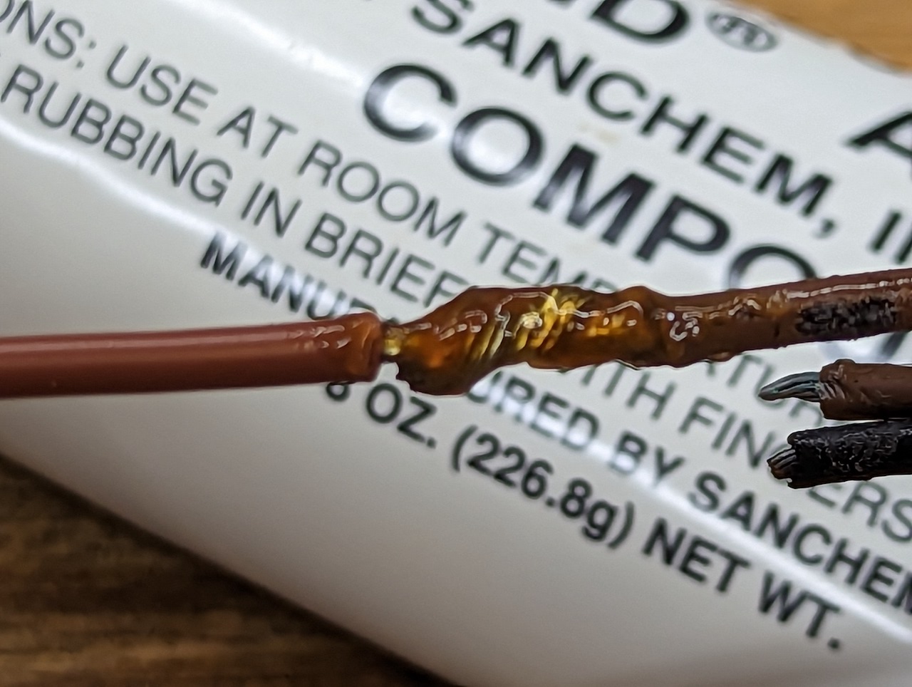

Next I protect the exposed wire with No-OX-ID special grease This improves conductivity and protects the wire from exposure to water and humidity.

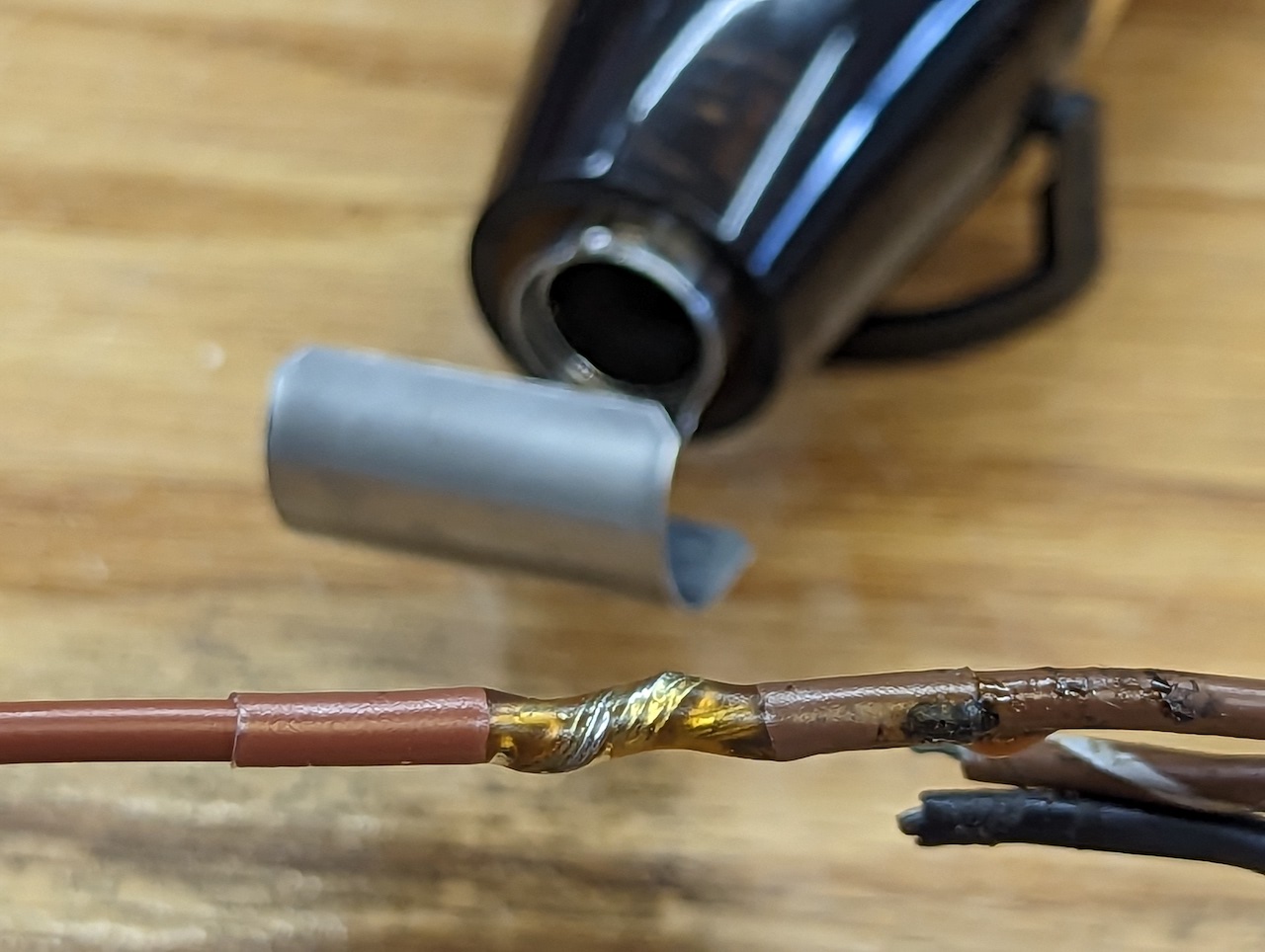

Finally I slide the heat shrink over the soldered wire and apply heat with a heat gun. Note how well the clear shrink tube shows the grease protecting the solder joint. Unless you are showing polarity with red or black shrink tube, or need some other color scheme, use clear tubing.
Summary
It is nice getting things done, with the right tools, knowing that you probably won’t have to mess with it again for a long time. The connection between these two wires that should last for years.
