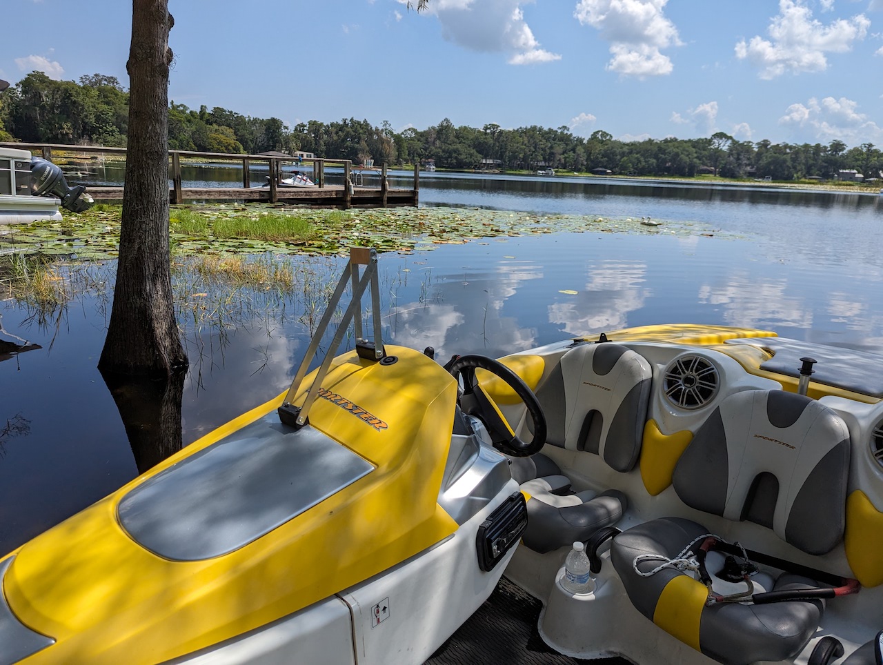

Basic steps:
- The painful part was drilling four 1/4” holes to hold the two wooden blocks. The holes could be filled, sanded and painted over if the bracket would not be finding use. I mounted the blocks off the the side of the hatch release button but it can also be mounted dead center, just behind the button.
- The blocks are cut to size, sanded and painted black.
- Aluminum flat bar is cut to length, 2 x 10” for the vertical bars and 2 x 16” for the angle bars. Flat bars are 1/2” wide by 1/8” thick.
- 1/4” holes are drilled in each end, nice and symmetrical, 1/4” from the end and 1/4” from each side.
- Note that the vertical bars have an extra set of 1/4” holes that keep that block from spinning, and also attach to the angle bars.
- Finally, it is all about the fasteners. Stainless steel if you can find them, zinc if you must. I went with wing-nuts making it easy to take off and stow when not in use.
- Clamp on a nice sized mirror and you are good to go.

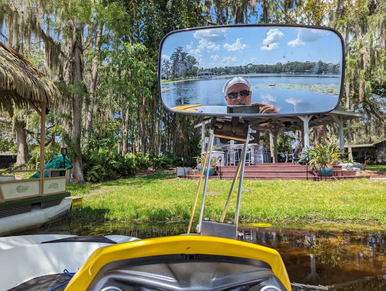

The Final Product, Sea-doo Sportster Ski Mirror
Here is the view from the driver.
- The driver can see through the bracket with a clear view of all the water in front of the boat.
- The driver has a clear and wide view behind the boat. The mirror is place high enough to look over the drivers head and bimini. When I mounted the mirror directly to the mounting block, my big-head was in the way of seeing the skier and also, not shown here, the bimini was also blocking the view.
A great view of the water with this elevated mirror stand.
