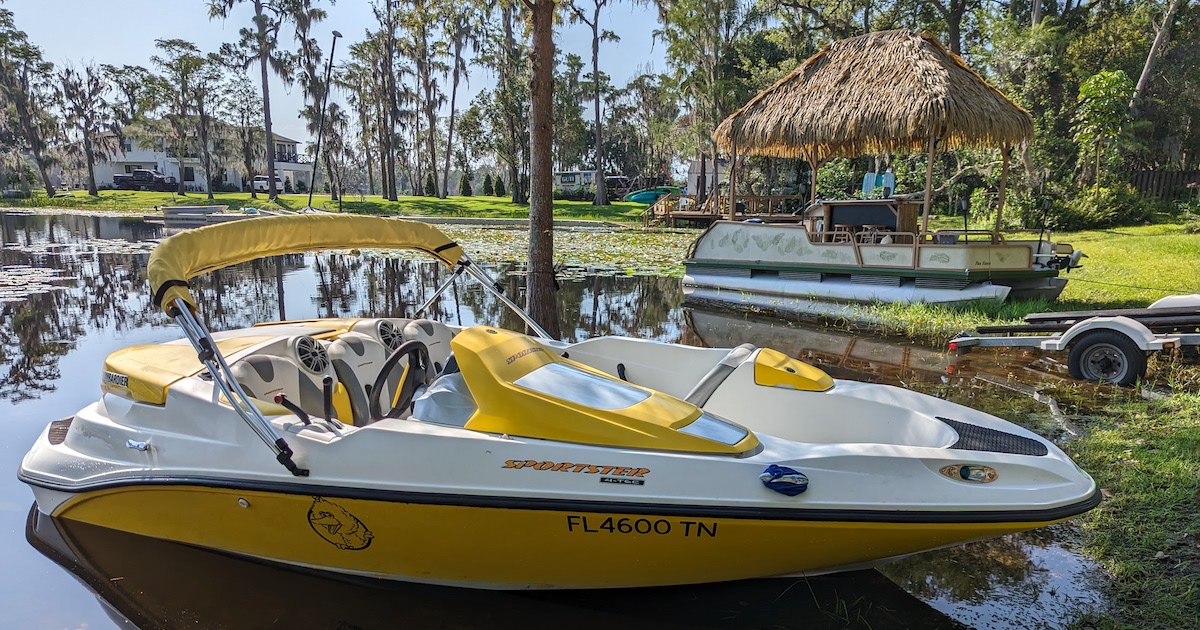

New to me, I’ve got a 2003 Sea-Doo Sportster 4-tec. These are fun little boats, although some specific Sportster parts are difficult to find, i.e., electronics, the 4-tec is still popular today and used in many jet skis and boats.
