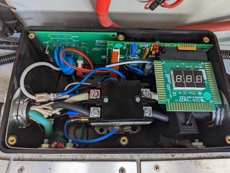

The surge protector display was dark, with no sign of life showing whatsoever. I took off the cover and with obvious caution, tested across ground to L1 and L2, and between L1 and L2. Seeing 123.2 on L1, I figured the inputs were fine and how wrong I was.
It doesn’t look pretty but it worked yesterday
When I saw 123.2 volts across ground and L1, I thought the cord was good. Only later did I discover the test was not complete.

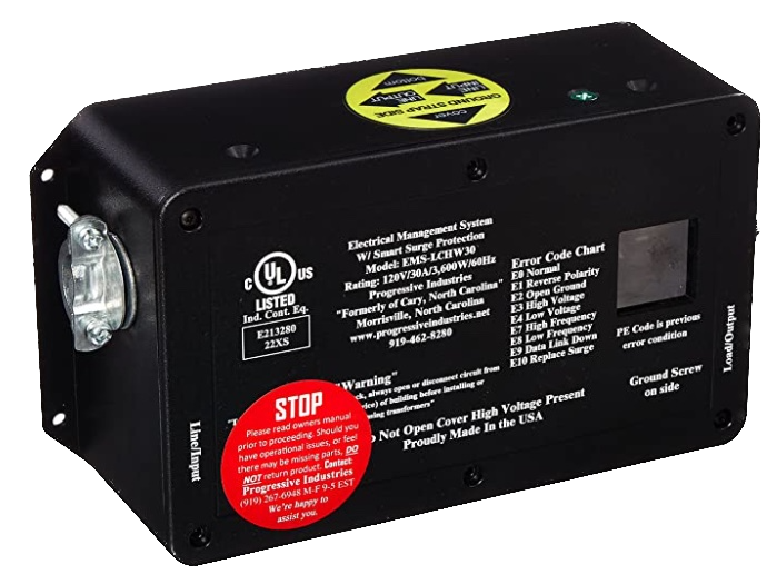

The Permanent Mount Smart Surge Protector
Surge Protectors are devices that are generally made in two form factors, what I call the dongle style, and the permanent mount style.
- The dongle style are less expensive, and a device you typically plug into the outlet let’s say a campground, and then you plug your power cable into it.
- The permanent style is built into your RV, and it is the first device that connects your RV to the outside world.
Why would you need one of these in the fist place?
Handling power for 100 or 500 RV is not a simple task. Add to that a surging electrical grid, lightning, salt air corrosion, and the occasional drunk electrician, and just about anything can happen. So why take chances, buy one, use one!
I went with a permanent mount for ease of use. Over a period of time you will plug in your RV again and again, and I wanted the process to be as simple as possible. So I went with a nice one.

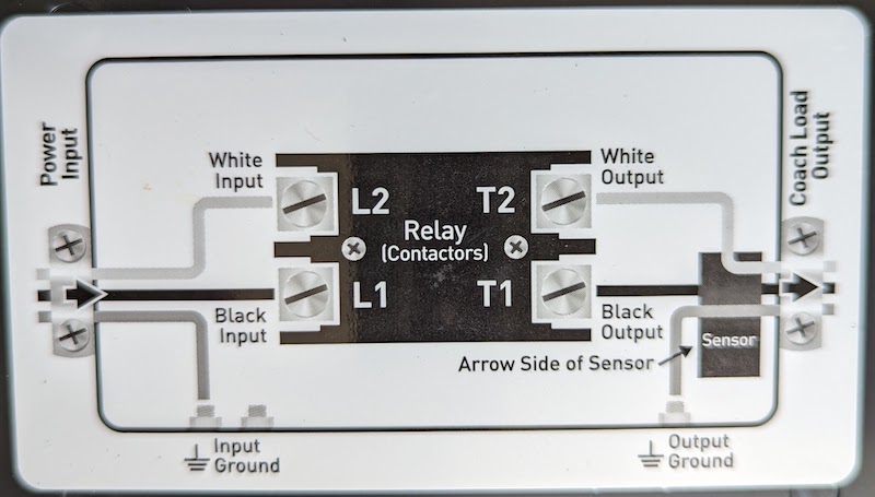

When you take off the cover. What you will find inside is a large relay in the center with A/C inputs on one end and A/C outputs on the other end. There are two printed circuit boards that supply all the logic for monitoring 10 unique fault conditions. A small coil measures current.

I checked the van to notice that the battery bank was down to 82%, yet it was plugged in. After checking the breaker, I plugged a heat gun into the end of the power cord, just to test it and it worked, or so it seemed. Thinking the inputs were fine, I went inside the surge protector, and made the measurements above. I’m thinking there must be a fuse in the box or something wrong with the box, but there was nothing obvious so I get Progressive Industries on the phone.
The service tech really new his stuff. I gave him the results of my tests and he said it must be wired incorrectly. Well I had used it for 9 months, and I had followed instructions and was pretty sure the wiring was correct.

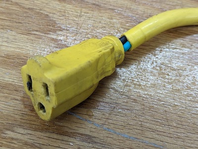

He said something that got me thinking. Let’s simply put a different extension cord on it and see if that works. Low and behold that was it. But why did the heat gun work earlier? The extension cord had only partially failed.
Let’s test the extension cords
We were on to something, so I went out and bought a 110 outlet tester from one of my favorite brands, Klein Tools. Testing the extension cord showed a bad neutral line. While not needed for this test, the outlet tester also test GFCI faults.
After replacing the cable end, the extension cord was good to go.
This extension cord plug was highly rated. After installing it I can see why, quality materials and quality construction.
