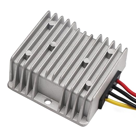

12 Volt Buck Boost Power Converter
Even through the RV has a large battery bank, the voltage can vary from 12.5 volts to 12 volts when turning on/off appliances, or when the A/C cycles. The Buck Boost converter will supply a steady 12 volts.
