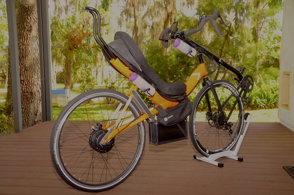

Overview Cruzbike S40 Ebike
The Cruzbike S40 Ebike is built on the Cruzbike S40 frame, a short-wheelbase high riding recumbent, a 500 watt (peak 1056 watt) motor, a 48 volt 20.8 Ah battery, disc brakes, SRAM components, Schwalbe Marathon Plus tires with custom battery bracket, custom controller bracket, and a custom torq arm. The bike is 2-wheel drive, the front wheel human is powered and the rear wheel is motorized. It was designed specifically for the Horrible Hundred bike event in Clermont Florida. If Florida was a pancake, the Horrible Hundred crosses over about 20 large blueberries.
Cruzbike S40 Frame
Cruzbike’s are known for high performance and comfort. High performance comes from a relaxed recumbent position, low aerodynamic profile and the biomechanics of front wheel drive. You can check the crazy list of records here.

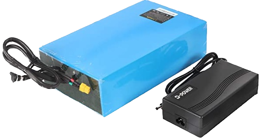

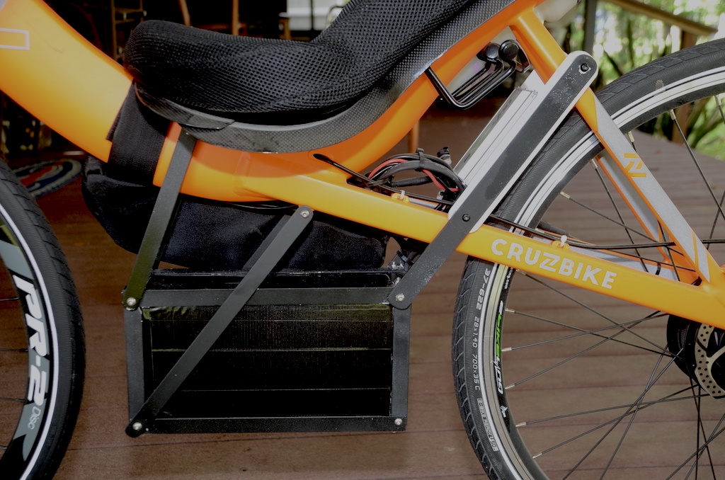

LG Bare Cell Battery
Loaded with capability, 998 watt hours at 48 volts, the battery also has significant liabilities. It is massively heavy at 11.3 lbs, more than half the weight of common road bikes made today.
Not only is it big, it is expensive. It cost more than the ebike conversion kit.
In the flatlands of Florida, the biggest factor is not weight but is aerodynamics, followed by rolling resistance. Just the same, the bike and rider will be challenged to complete the Horrible 100 including its 1377 feet of elevation change.
48V 20.8AH RECTANGULAR BARE LG CELL BATTERY
- Li-ion Battery pack is made of 2900mAh LG Cells
- Combination 13S8P
- Charge Limited Voltage 54.6V
- Discharge Limited Voltage 39V
- Charge current 2A
- Charging Mode CC/AC
- AC Input 100-240V 50/60 Hz
- Cycle Life 1000 cycles
- Charging Time 4.5 hours
- Battery 11.3 lbs, 5.13 kg

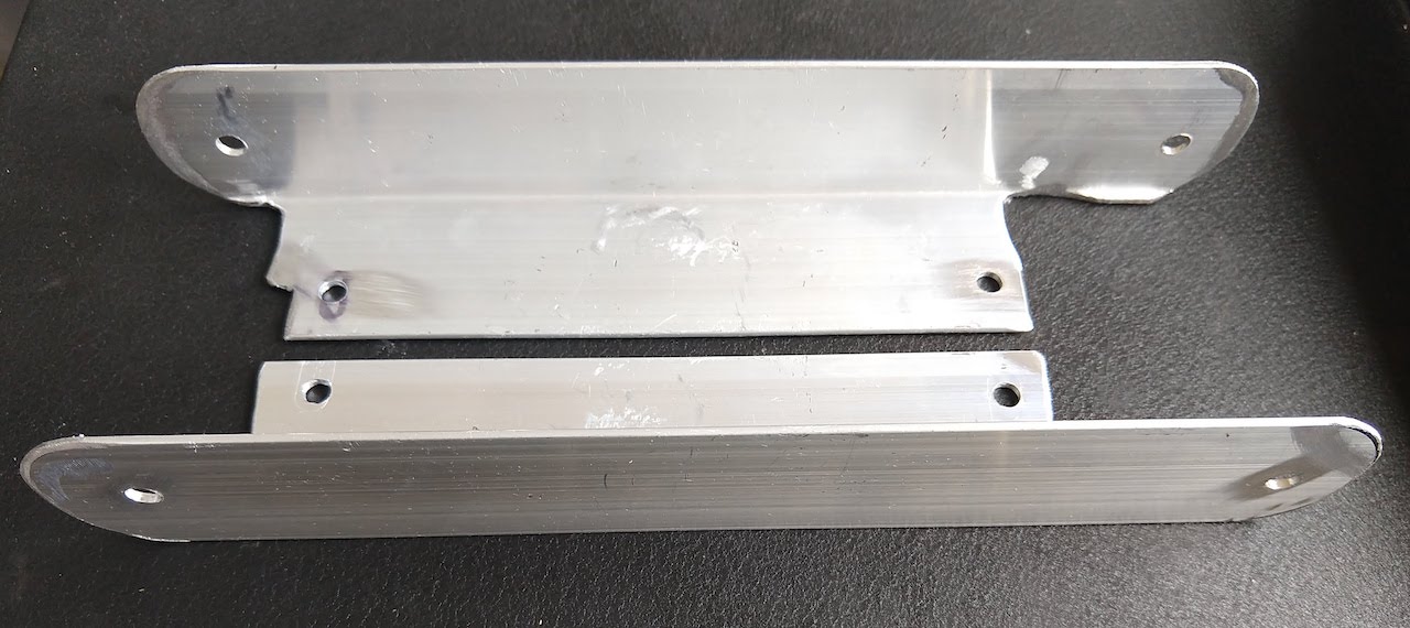

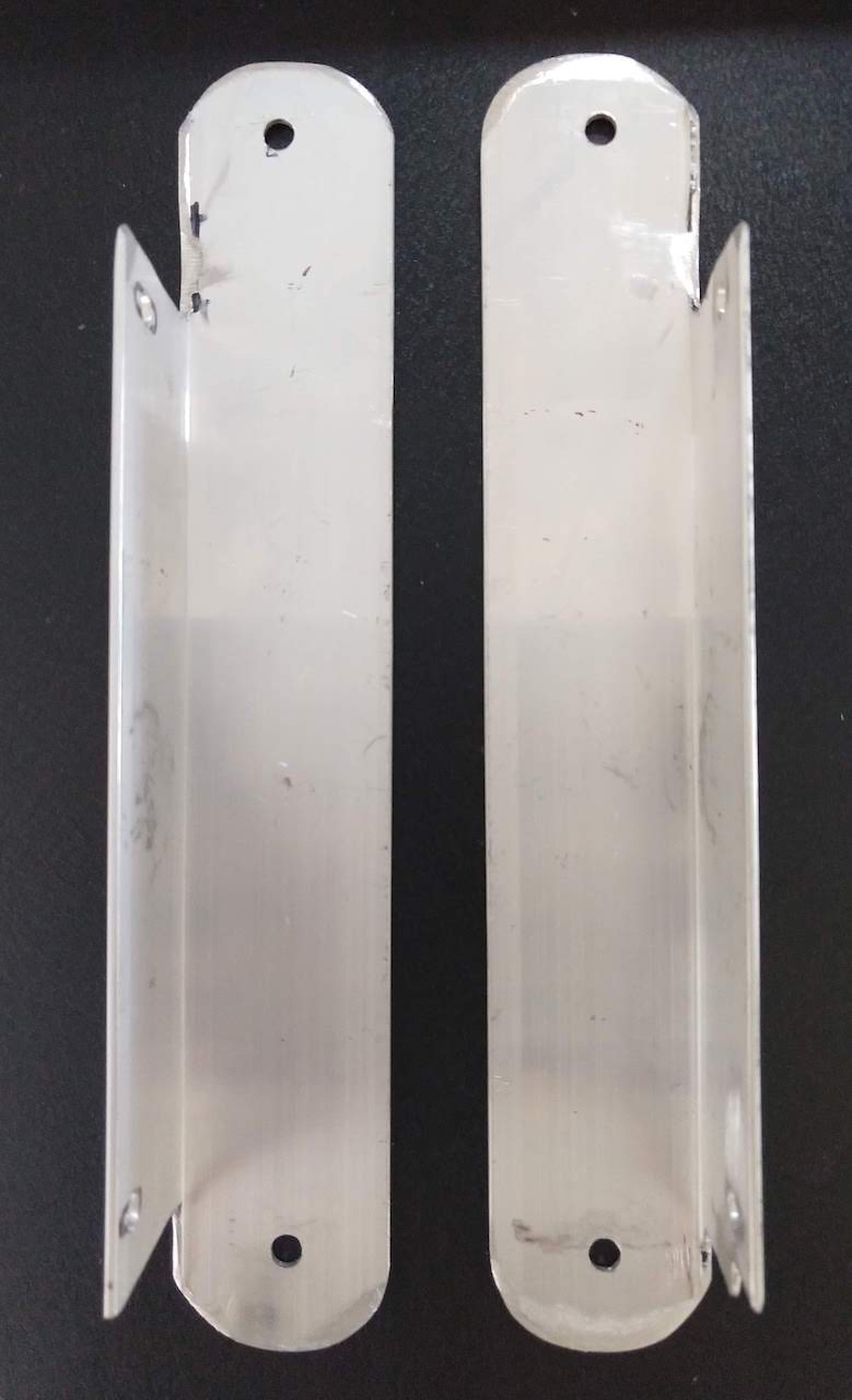

The location and construction of the battery bracket was a major design focus. The concern was that over time the aluminum attachments would fail due to the weight and shock of a heavy battery relentlessly pulling on the bike frame. The design has a rectangular bracket enclosing the battery and six separate attachment points to the frame to distribute the load. The main attachment point shares the attachments with the controller. This bracket provides both vertical support and horizontal support to keep the battery from swaying front to back and side to side.
Like most road bikes, the CruzBike S40 does not have front or rear shocks with the only shock absorption being the slightly oversized Schwalbe Marathon Plus tires. Pumped up to 90 psi (6 bar), these tires require 22.6 watts to roll a load of 92.5 lb (42 kg) at 18 mph (29 kph). Just considering rolling resistance and ignoring wind resistance, elevation change, mechanical chain resistance, etc., this battery at 22.8 Ah, discharged at 39 V, use 811 Wh should last 35.8 hours. It appears this is far more battery than we need, and this is without pedaling!

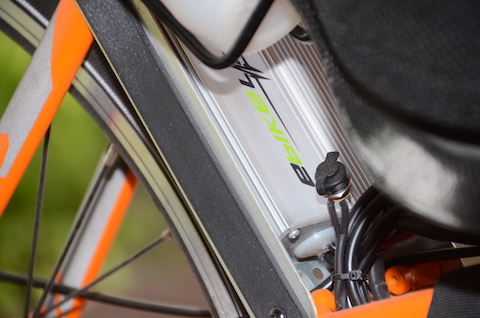

Controller & Custom Bracket
The controller is fairly light weight requiring only a modest bracket design to secure it in place. The bracket uses a pair of aluminum L-channels;
The motor cable was just long enough to fit in a natural place without the need for an extension cable.
Note the covered plug, this is how you charge the battery. The kit comes with a brick style battery charger.

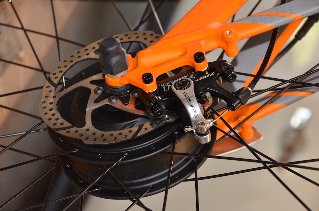

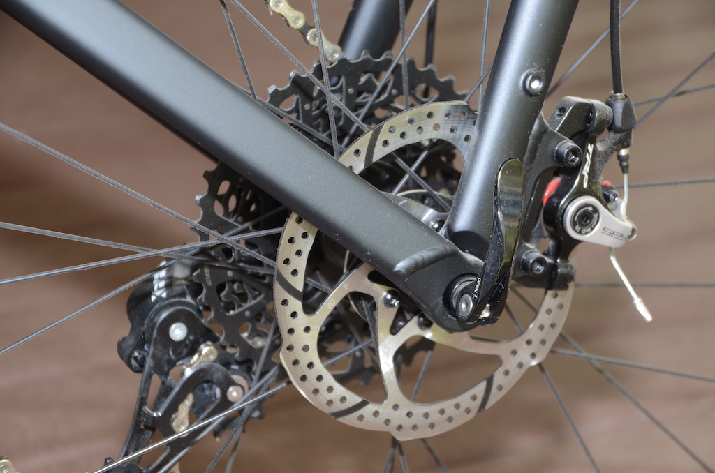

500 Watt Geared Motor & Torq Arm
Given the bike is built for endurance and comfort, the selection of a 500 watt motor fits the bill. See the section The section About Power covers the topic in detail, but know the subject can get complex. A 36 volt motor 500 watt motor that is powered by a 48 volt battery will generate more than 500 watts of power.
Note the custom torq arm. The kit came with a short stainless steel torq arm and a band clamp. I figured the band clamp would scratch the paint so I fabricated an aluminum torq arm that bolts nicely into the chainstay islet.

TRP Spyre Alloy Mechanical Road Disc Brakes
These are nice low-maintenance brakes. The large 160 mm rotors give the brakes the leverage they need to stop quickly with even control.

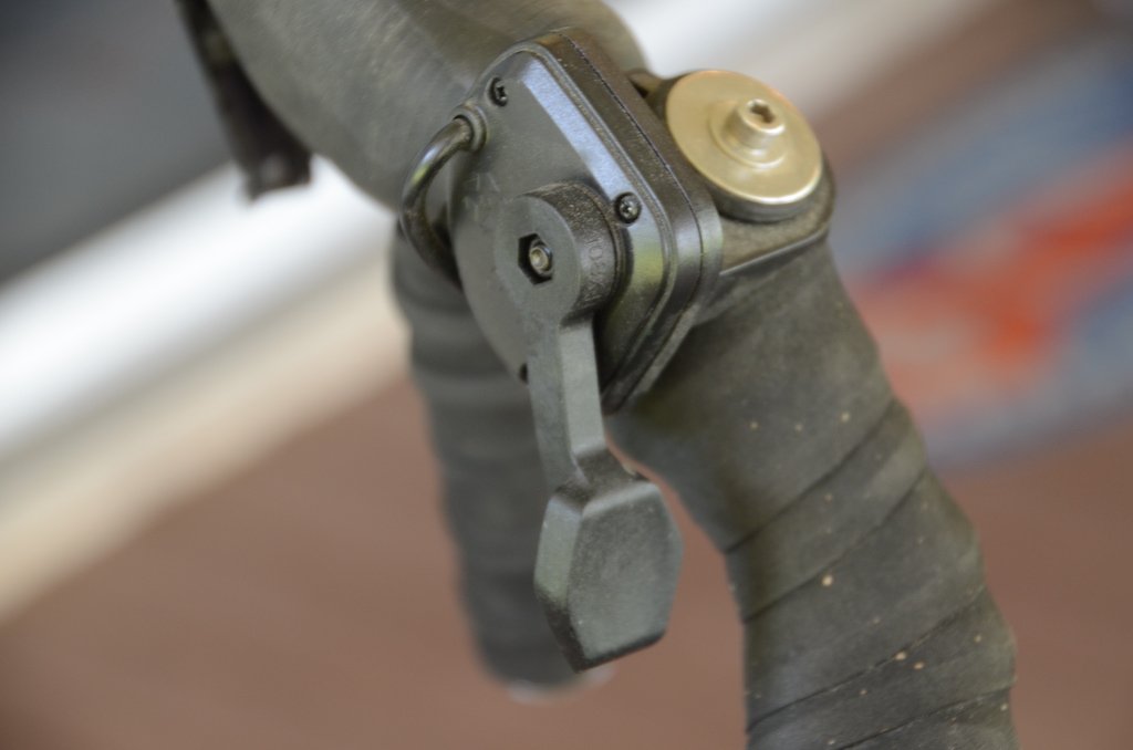

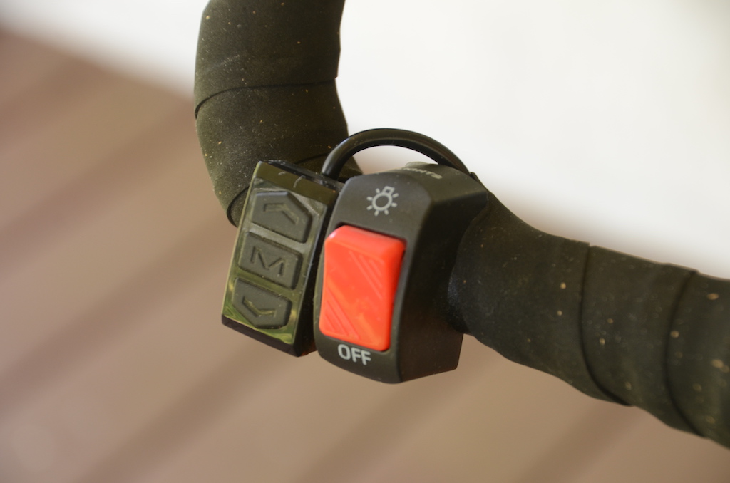

Additional Handlebar Controls
The 3-button switch controls the bike on-off state, sets different pedal-assist modes and allows user configuration of the motor controller. See the second on S830LCD Display & Configuration for details.
User can operate the thumb throttle with both hands or just just the right hand, while maintaining access to one or both brake levers.

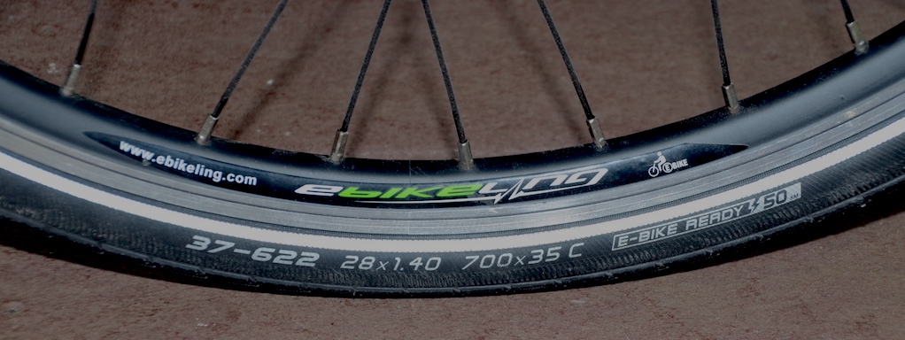

After some assessment, I chose to use Schwalbe Marathon Plus tires in a 700x35c size.
| Wheel | Inside Width | Outside Width |
| Front | 17.4 mm | 23.2 mm |
| Rear | 18.8 mm | 24.8 mm |
I wanted a larger tire to provide a smoother ride and chose durability over speed, i.e, to have a heavier tire with thicker tread over a lighter tread with thinner tread. The table above is with tires inflated to 60 PSI. When inflating tires to 90 PSI the difference between the Parathon Plus and tires about half this weight is a little more than 2 watts. For me, the additional durability was worth the 2 extra watts required to move down the road.
One small task is to remove the small rubber nubs from each tire as these will introduce a small amount of aerodynamic drag. Use your fingers or small needle nose plyers. Technically these are called vent spews and are an artifact from the manufacturing process. More information here.

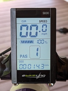

S830 LCD Display & Configuration
The eBike controller is configured from the S830 LCD display.
2
3
4
5
6
7
8
9
10
11
12
Enter settings mode
* Power up the unit using a long press on the center button.
* Long press up and down buttons to change a parameter value and advance
to the next parameter.
* Use the center button to advance to the next parameter.
To edit parameter P03.
1. Long press the center button to power up the unit.
2. Long press the up and down buttons to enter settings mode.
3. Shrt press the center button twice to advance to P03.
4. Short press the up and down buttons to change the parameter.
5. Short press the center button to save changed parameter.
| Parameter | Value | Description |
| P01: | 3 | Backlight Brightness (1: darkest; 3: brightest) |
| P02: | 1 | Mileage Unit (0: KM; 1: MILE) |
| P03: | 36 | Voltage Class: 24V /36V / 48V |
| P04: | 10 | Hibernation Time (0: never, other figures refer to the hibernation time), Unit: Minute |
| P05: | 1 09 | Power Gear – 0/3 Gear Mode: Gear, 1/5 Gear Mode: Gear, P05 means how many assist grades you want from the motor. |
| P06: | 29.0 | Wheel Diameter Unit: inch Precision: 0.1 |
| P07: | 86 | Magnet Steel Number for Speed Test Range: 1-100, Set magnet number P07 to 47 if it’s direct drive motor and if the motor is geared then it should be set to 86. |
| P08: | 50 | Speed Limit Range: 0-50km/h, parameter 50 indicates no speed limit. |
| P09: | 1 | Zero / Non-zero Start Setting: 0: Zero Start, 1: Non-zero Start |
| P10: | 2 | Drive Mode: 0 Pedal Assist only, 1 Throttle only, 2 Pedal Assist and Throttle |
| P11: | 2 | Uncertain. If you know what this does let me know. |
| P12: | 3 | Assist Power Intensity Range: 0-5, P12 means pedal assist sensitivity, from 0 to 5 shows how sensitive you want your pedal assist. |
| P13: | 8 | Power Magnet Steel Number. For eBikeling set it to 8. |
| P16: | 8 | ODO Zero-Out: Long press the upper key for 5 seconds and ODO will zero out. |
