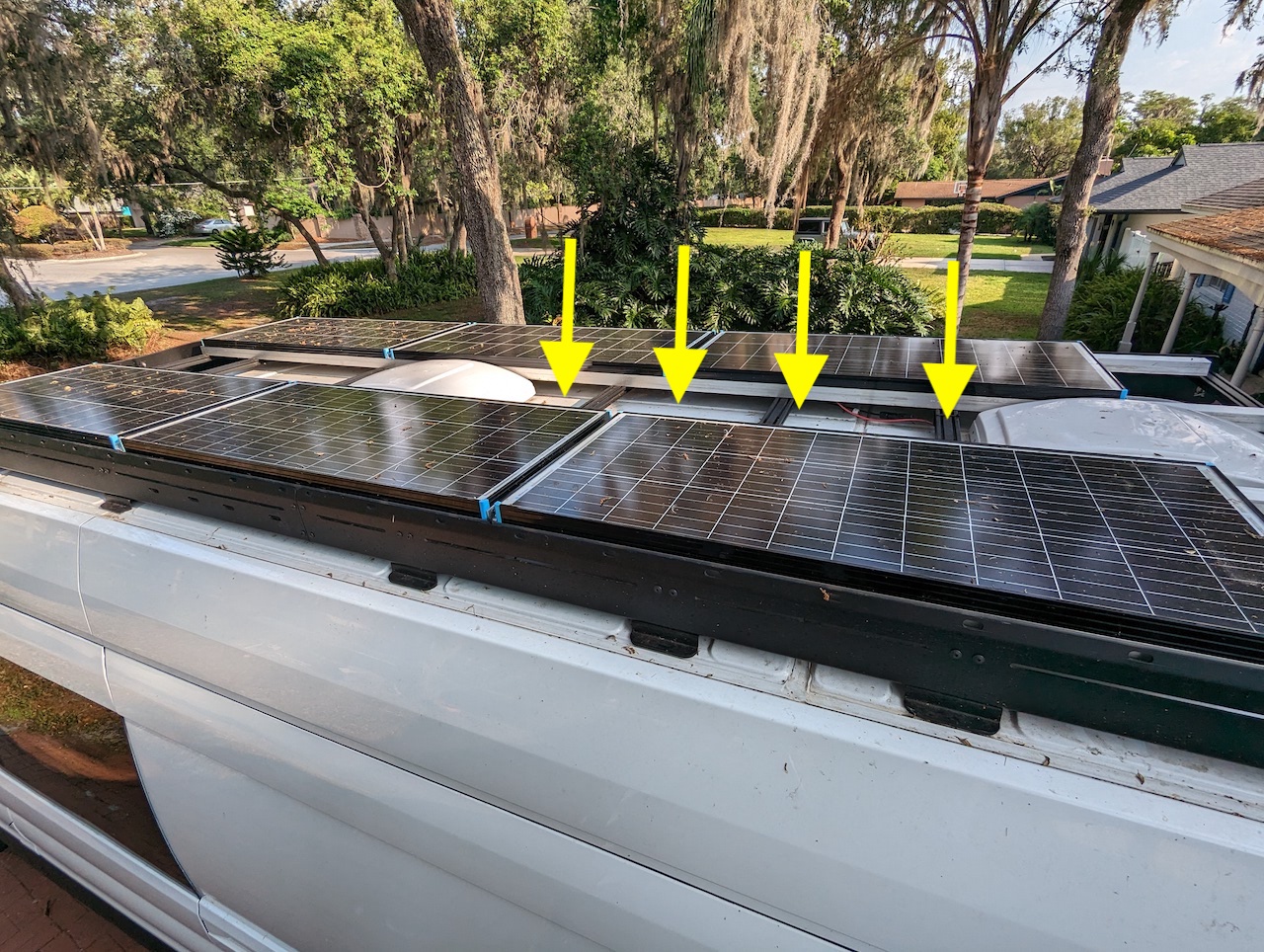

It’s purpose is to deploy and stow an antenna array for Internet and Wifi communications. The system has enough capacity to accommodate video cameras or other accessories in the future. The system is sub-component that fits tightly between the solar panels and in-between the two roof fans, on the roof rack. The current antennas increase the RV height by 18”, to a total hight of about 11’ 6”. At the current hight of 10’ we often brush low hanging branches.

The sub-system, when installed fits perfectly between the two rows of solar panels, and between two cross rails. First make the sub-system rack fit where it needs to be installed, with a little (1/4”) leeway. This way you can move it to your workbench while avoiding all the up/down time and travel your RV roof.
The frame is made from lightweight 3/4” tube aluminum, and the fasteners are corrosion resistant stainless steel. The linear actuator completes a 50 mm movement in about 1 second, converting linear motion to 90 degree rotational motion. The linear actuator is quiet at less than 45 decibels, it operates on 12 volts DC, and at temperatures from -25 to +65 degrees C.
