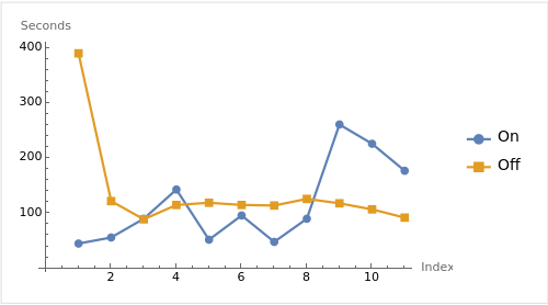

In an unscientific manner, I timed a few On/Off cycles. A former co-worker once said, “all data is flawed, some data is useful”.
| State | Seconds | State | Seconds |
| On | 0:45s | Off | 6:30s |
| On | 0:56s | Off | 2:02s |
| On | 1:30s | Off | 1:29s |
| On | 2:23s | Off | 1:55s |
| On | 0:52s | Off | 1:59s |
| On | 1:36s | Off | 1:55s |
| On | 0:48s | Off | 1:54s |
| On | 1:30s | Off | 2:06s |
| On | 4:21s | Off | 1:58s |
| On | 3:46s | Off | 1:47s |
| On | 2:57s | Off | 1:32s |
| Average On | 1:45s | Average Off | 1:56s |
Understanding the A/C Unit’s Efficiency
The air conditioning (A/C) unit tends to be switched off slightly more often than it is switched on. While operating, it typically consumes around 800 watts of power. However, given that it’s not running more than half the time, its average power usage is less than 400 watts.
Our battery bank has a capacity of 9,600 watts. Based on these figures, it’s theoretically possible for the A/C unit to operate for a full 24 hours using only the power stored in the battery bank, thus functioning off-grid.
However, it’s important to note that these conclusions are based on a 3-hour test, which may not provide a comprehensive understanding of the A/C unit’s power consumption patterns. Therefore, more extensive testing would be necessary for a more accurate assessment.
